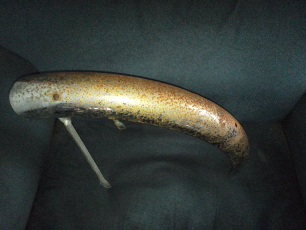

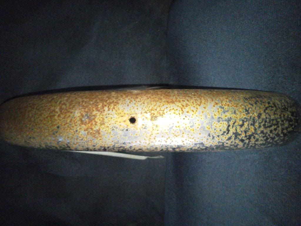

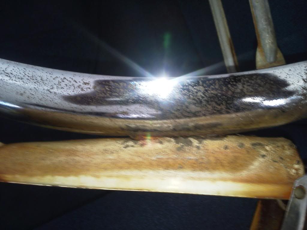

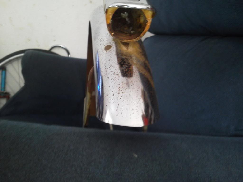

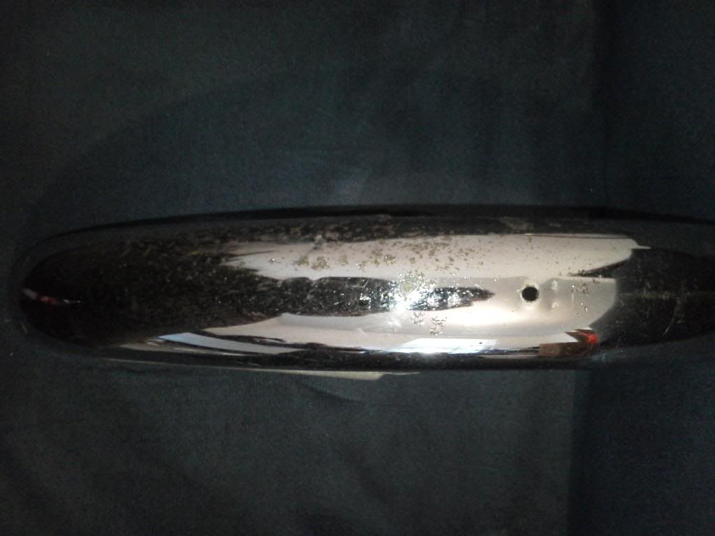

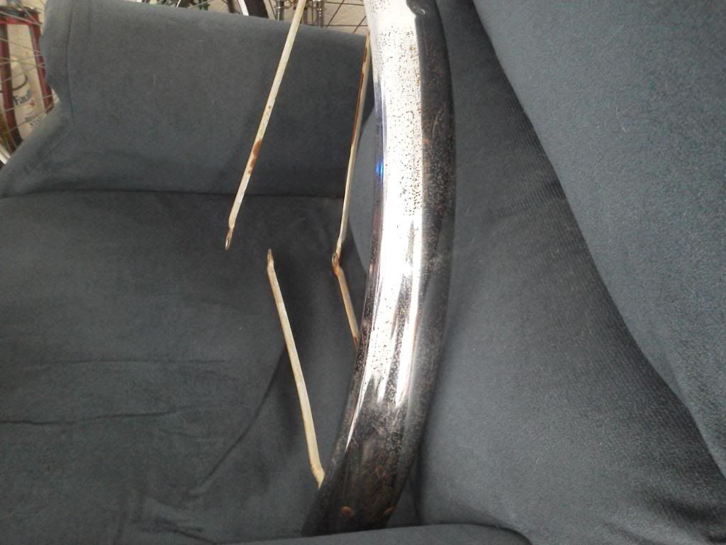

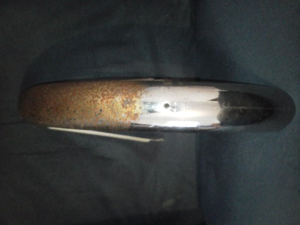

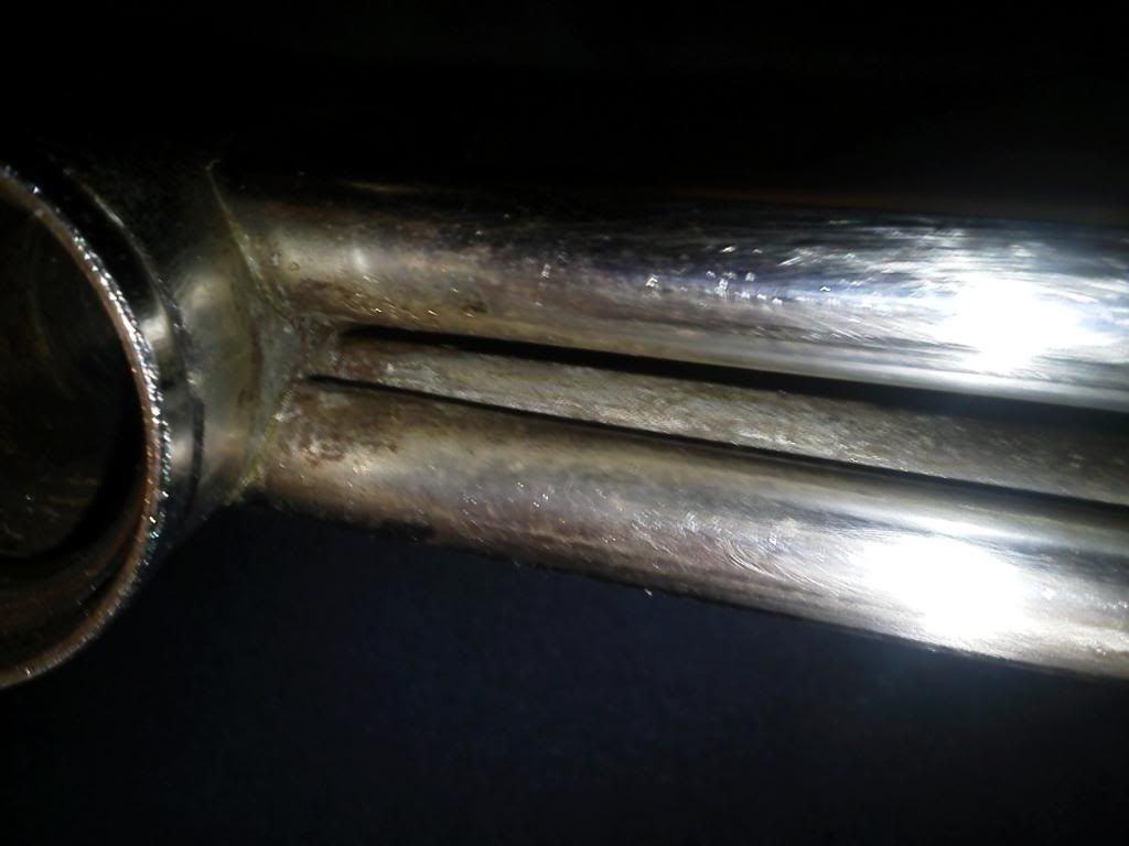

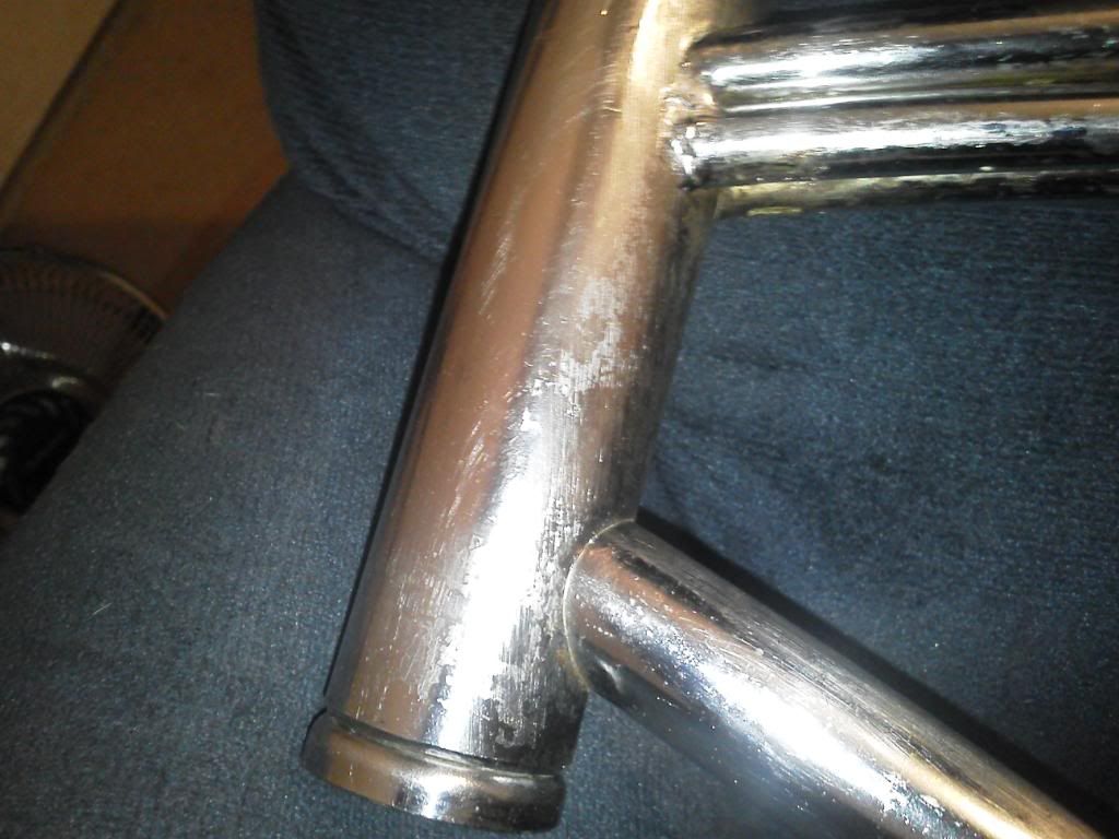

What to use for cleaning chrome & rust, here is mine but anyone else knows other ways then go ahead and post it.
I have been using Turtle Wax Chrome Polish & rust remover sold at Walmart for $1.98 on my chrome bicycle parts, I shake the bottle well then then there is polish in the cap a put my finger in it then spread over a small area at a time then I use a brass brush as hard yet light as I can.
Here are Before & After pics.
Before
After
Different Fender Before
After, some spots can not be helped because the chrome is gone & pitted.

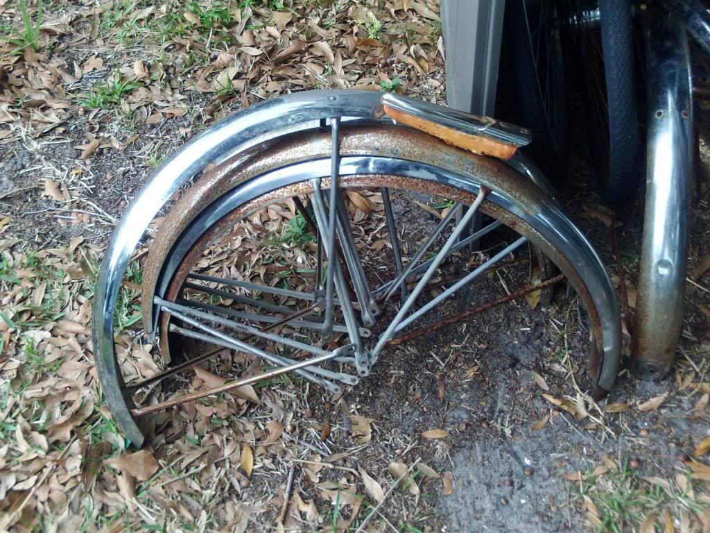

I know people that used wood bleach with a lot of water for rusty chrome on bicycles where there is areas that no brush can get to like on Spaceliner bicycles have as you can tell in the pics below.
