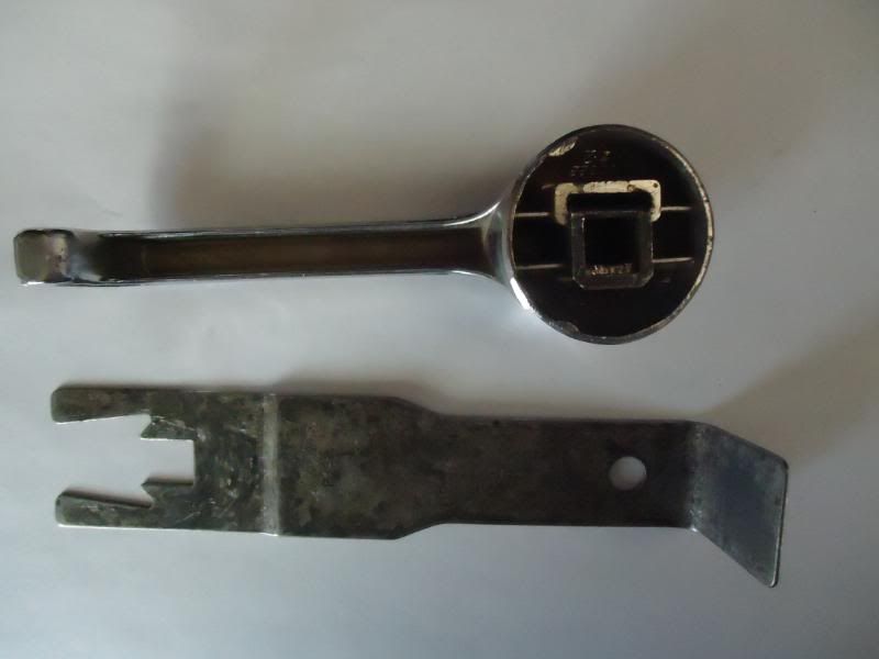

Here is the tool I use, it was not made for this type of handle but it wqorks pretty good. I have had it for probly 30 years or more.
Also a door handle off from as 58 Beleverdere , They are all the same though. Smile

Well done Sir Robert of PLYMOUTHSVILLE.........The part you need to push on is the
square clip on the handle......you need to push the section at the bottom(6 oclock in the photo) to remove the handle.......window winders are the same.

Wow! Thnxs guys but looking at the pic of the square inside of the handle, is there something inside the square like u say at the bottom. To me it looks like the top piece would have to move up? If Im wrong, where is it possible to purchase one of these tools or could I get inside with a 90 degree o ring pick?

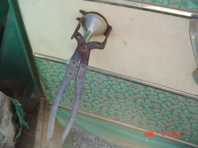

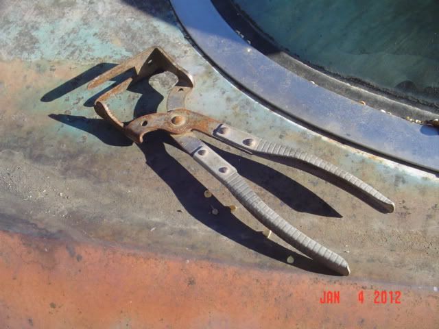

Here's a photo of the one that I use. I bought it off either the Mac or Snap-on tool truck during my first years as working as a mechanic. I believe the maker of these pliers was Lisle tool company.
You just slide the tool in, squeeze the handles, and pull.
