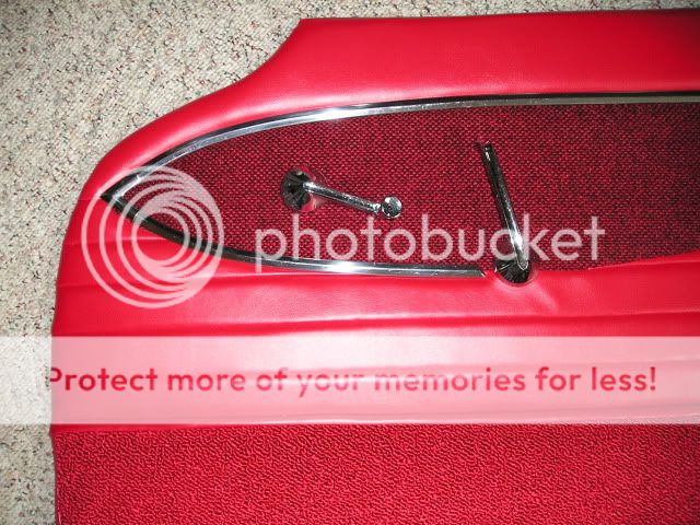

Door panels are a lot easier then seats. This is how I did mine but please don't think the design is correct for any car because it is not. It's just what I came up with to match my seats and the trim I bought to go on them.
This is the parts that were with the car and a lot of help in making the new ones.
Photobucket

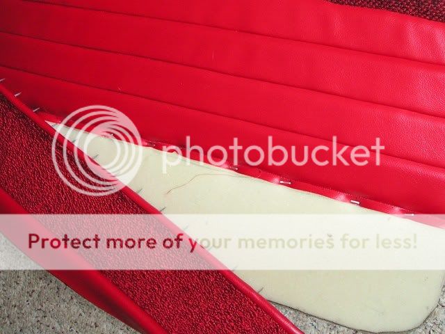

You can make a pattern for the hard board from the door or old panels and cut the holes for the clips and handels before covering them.
I made the pleats the same way that I did on the seats then sewed the fabric and vinyl together and stapled and glued it in place.
Photobucket
I sewed a wide piece of the vinyl first along the sides and across the lower edge and a second piece across the top. A nail strip was added and the top strip is folded back down over it.
Photobucket
Photobucket
The side and lower edges are wrapped around to the back and finishes the sides of nicely. Now you can cut out the areas for the handles.
Photobucket
Photobucket
The scrim foam padding makes it look soft and cozy. If any part of this isn't clear I will try harder to explain it. Smile

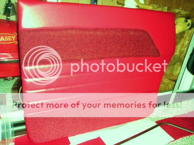

This is the carpet. I ordered it and some extra yardage for the doors at the same time so it would all come from the same die lot.
Photobucket
Photobucket
Photobucket
I tacked it to the wall so it would stay nice tell the day comes for it to get installed in my Christine.Photobucket
