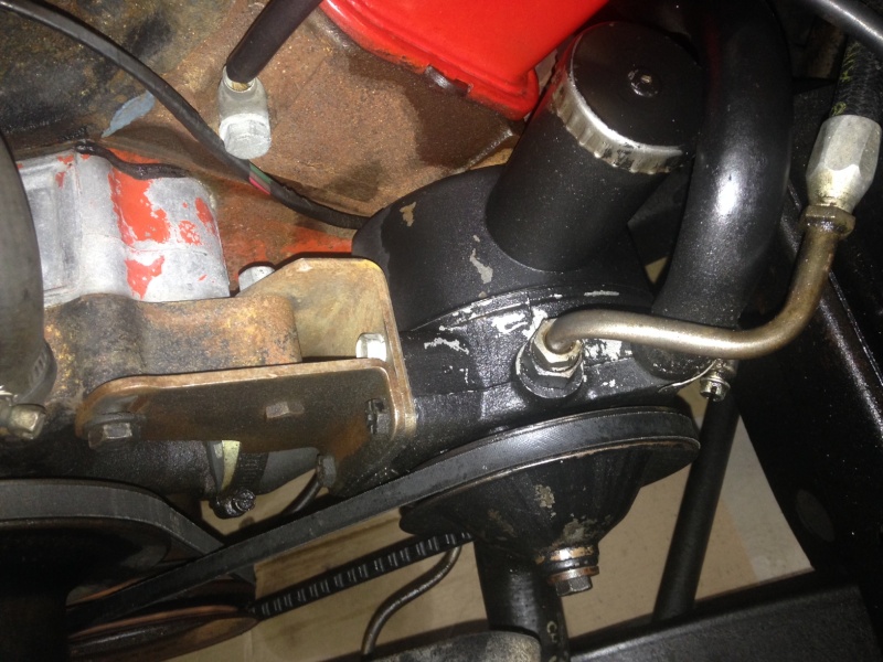

PostSubject: Re: Pumps "O Plenty"... YIKES!   Sun May 01, 2016 9:35 am
I did a lot of research on my pump about a year ago. Problem is...I forgot a lot of it. You certainly may be right about yours being Thompsons. However, I do remember this Wayne. Mine looked to be correct according to the FSM...so apparently it was transferred over from my car's original 318. Here's a couple photos. Looks to be different from yours.

PostSubject: Re: Pumps "O Plenty"... YIKES!   Sun May 01, 2016 11:10 am
Thank you for your input Bob. Looks like you are right about the bracketry. One is no doubt for the 318 and the other for the 350. As for your pump I'd venture a guess that it is not a 58 pump, unless they used more than the two I pictured. I did find these pics though and it looks to me like I have two options depending on what I decide to go with...
