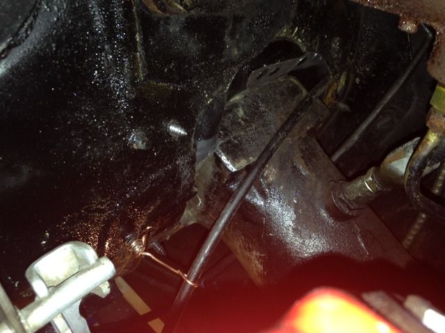

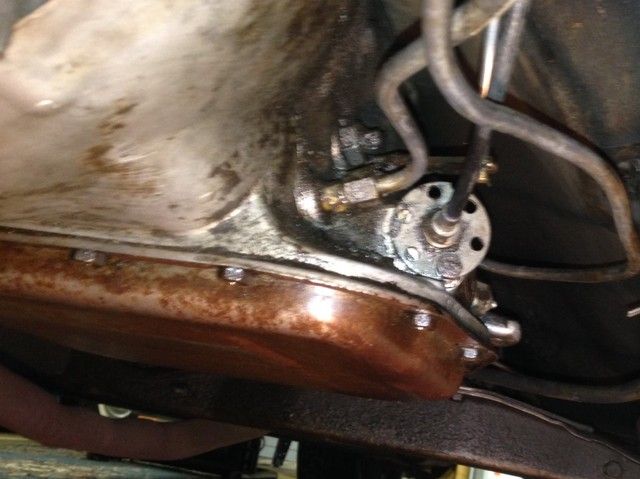

Hi guys...Got a 64 Torqueflite Transmission in my 58 Plymouth. Cable is too short. Need to reroute it...or most likely replace it with a longer one. To replace it I have to know length and what type ends are on it...probably will need to send it off to specialty cable shop too. So...I need to know what to expect when I remove cable from transmission and what it will take to reinstall it. Simple?...Pain in the neck? Anyone have any experience in this area?
Thanks, Bob

Bob, check this MTSC film out: https://www.youtube.com/watch?v=hOrl73eNmOo
Easy job to do with just removing the neutral safety switch. I have a 1960 Transmission in my '58. Your transmission should have the adjusting wheel on the trans end like mine. Atlas Obsolete custom made mine years ago and although it was big money, it worked great. I think the cable out of an early '60s Imperial or Chrysler would be long enough. Chrysler went to that simpler design in late '59.

Thanks very much JohnD...I really appreciate this information. I messed with it today...had the pushbutton assy. out. I'm going to run with it UNDER the dash to see if my theory is right. I should have reverse when it gets hot if cable is not "stretched."

Well...I'm reasonably sure that whoever put this 64 motor and tranny in the car used what they had in front of them at the time. The strange thing that keeps me wondering is that reverse worked when I first got the car a year ago. It worked fine when cold and when reaching operating temperature. I quickly realized things weren't right though when I saw how this shift cable was routed..."stretched" through the steering column hole. The rubber bellows that covered the steering column hole could not be bolted in place because of it. It was just sitting there, so fumes poured into the car. When I tried to bolt the bellows in place...obviously upsetting the shift cable a bit...the reverse no longer worked when car reached operating temperature. R button could be pushed in but not all the way to put the car into reverse. Still worked fine when car was cold. It's a long story...one that I think can only be remedied by getting a longer cable and routing it correctly.

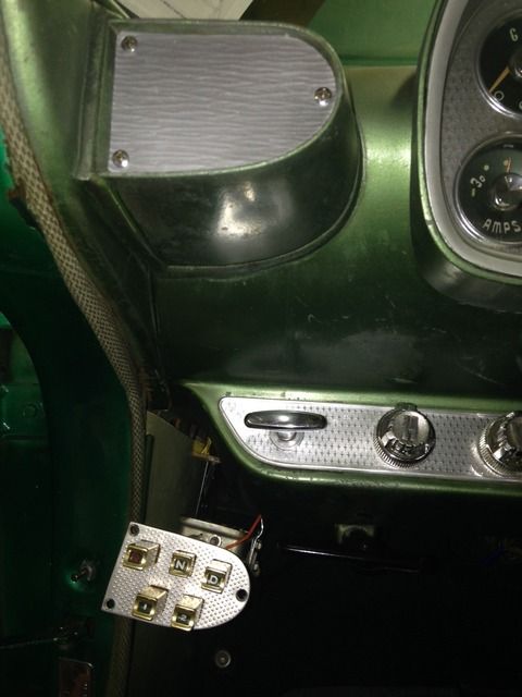

I wasn't able to run the car this weekend with the pushbuttons mounted under the dash to test my theory (that the cable isn't long enough). But I might as well get a head start on this process. Anyone know where to go for a longer cable? I might do it sooner rather than later if I can find a vendor that will have a quick turn around time.

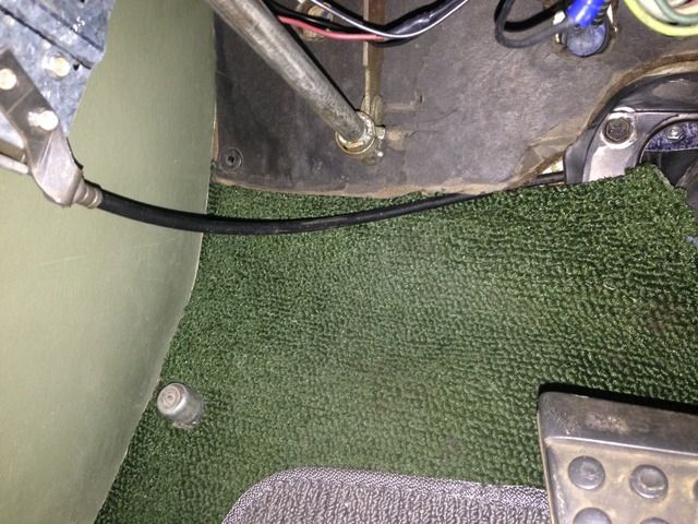

Update: Ran car after moving push buttons under the dash...(no stretchy the cable) ran car...no change...still no reverse when car warms up. Loosened/tightened neutral safety switch to 20 foot pounds of torque as per manual....no change...still no reverse when car warms up... scratch Anyone have any other ideas? Got the last idea from a guy over at Forward Look.
Bob

Brian...the R button pushes almost all the way down...just doesn't click in nicely....like the others do all the time or like it does when engine is cold. No engagement into Reverse until engine cools off.

I got it working...although I have NOT returned the pushbuttons to their rightful resting place yet. I followed the procedure in the manual...I'm paraphrasing here..."With somebody pushing the R button all the way in...push the cable in the trans. mount all the way in square to the mounting surface....turn adjusting dial clockwise to the next bolt hole...then an additional 4 bolt holes." With this adjustment I had R, N, D, 1, 2 when cold...lost R when hot and had neutral. But...I could push R in and it would stay in. I knew I was on to something at this point. I got to thinking about what John said...so I backed the dial off the 4 holes I that originally went (Clockwise). So I adjusted dial 4 holes counterclockwise. I tested it yesterday afternoon ...engine warmed up to operating temp. and everything worked fine. I conclude it a victory...BUT I still have to put pushbuttons back up to where they belong...(with a short cable). It worked when I got the car...just not an optimum setup. Thanks all.
Bob
Update: Installed pushbuttons back in factory location but cable was way to taught. Reverse and Neutral didn't work right off the bat. Cable is way too short. Will have to run this summer with pushbuttons under dash...and look for a longer cable in the meantime. No

This is the way I'll be running this summer. At least I have reverse when I push the R button in! I won the battle but not the war...yet.
I measured this particular cable that's in my car. Came up with 39" not including the ends that stick out of the sheath. Not sure what other cables out there that are stock. If anyone know please chime in.
Update: Here's what I have heard from one FL-er...42", 44" and 48" are stock lengths for 1962-1964...which are the years that will fit my transmission. Have not been able to verify this though. Saw some cables on e-Bay/asked sellers questions about length/no replies. Also, JohnD said (above) that Imperials from these years may "be longer." That may be my only chance to find a stock cable that will work.
Bob

This saga is not over...took GC out tonight (it was very hot here today) and again...it would not go into reverse after reaching operating temp. scratch Crying or Very sad
Mad  Bob
At least I got a good picture out of it...

Bob,
The issue is undoubtedly thermal expansion at the transmission. You may have an original 58 cable that is either to long or to short for the later model trans.
DO NOT have a cable made for a 58 plymouth that is simply longer. You need a cable specifically designed to mate the 58 push button assy to the later model trans. I'd bet dollars to donuts its either to short or the cable design is incompatible with the internal shift lever of the transmission. Your probably just barely hitting reverse when "cold" IMHO. I assume that when hot.. you hit reverse and have nothing? Is it in neutral or still in drive when this happens?

A 64 transmission wouldn't "receive" a 58 cable. Notice the transmission shot above...the shift cable sheath has fine threads with a dial (that has bolt holes). A 58 does not have the threads or dial. The push button ends are the same. Definitely need a 62-64 cable that's longer...how long? I'll have to figure that out. Too long would not be good either.
I found an original 61-65 Dodge truck cable today that's 54" long (had to message him and ask)...but the guy is insane on his price (e-Bay) $225.00.
http://www.ebay.com/itm/61-65-D100-200-300-Pickup-Truck-Torqueflite-Transmission-Shift-Cable-NOS-1927835-/361528633959?hash=item542cc92a67:g:56gAAOSwWBJXBTEp&vxp=mtr
Not sure if this would work or not. No doubt I'll be very careful what I buy especially at these prices. That's why I'm trying to get it to work now...with push buttons below dash in a spot where the cable is long enough. Want to rule out cable as being the culprit.
